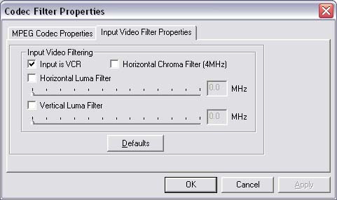

I would start with the settings for your DVC100 card. No doubt there is a filter turned on that smooths out the video from VHS captures. Since so many people use their capture card for VHS, this filter is usually set to default to "ON".
The filter tends to blur the video. If you're capping directly from your PS2, you don't need the filtering. Try looking in "Settings" or "Preferences" in your DVC100 setup applet.
Try that and let us know
Here's how my Snazzi III defaults the filter settings. Note the VCR input filter setting:
